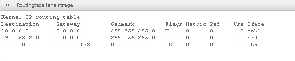

    Kernel IP routing table
    Destination Gateway Genmask Flags Metric Ref Use Iface
    10.0.0.0 0.0.0.0 255.255.255.0 U 0 0 0 eth1
    192.168.2.0 0.0.0.0 255.255.255.0 U 0 0 0 br0
    0.0.0.0 10.0.0.138 0.0.0.0 UG 0 0 0 eth1
    edit: is von der formatierung vl. schlecht zu lesen, im anhang isn screenshot
